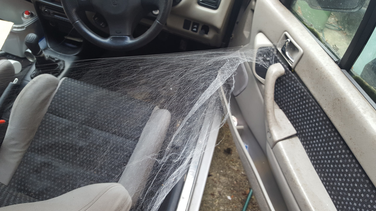

Rears are tidy, no rips or tears but they have mould on them.
The drivers bolsters are good, oh and the cobwebs are free. :laughing2
Located on the Wirral.
