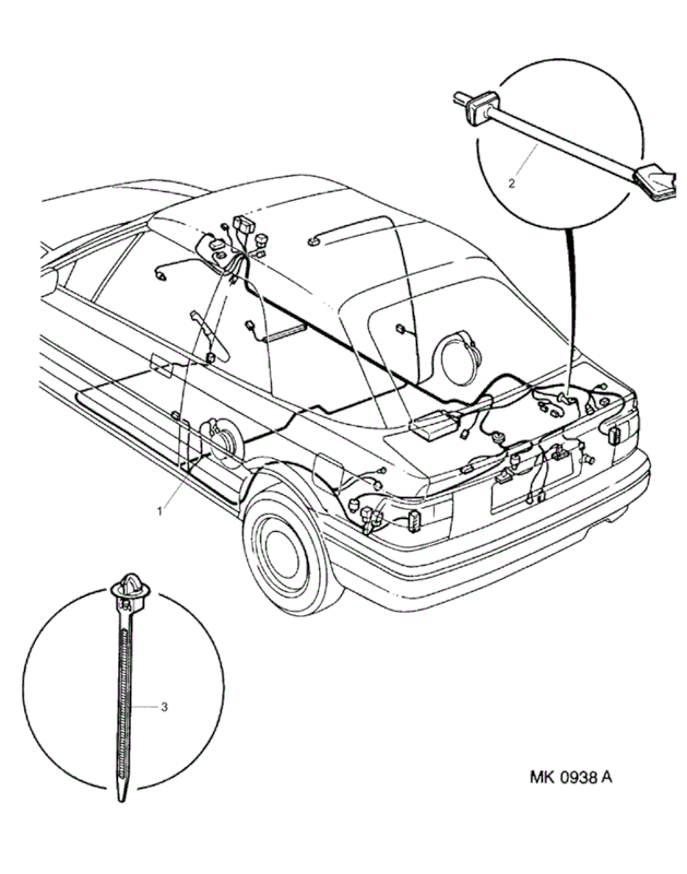

This has been a subject I have been dealing with for a while, like a lot of other Cabby and Coupe
owners the ribbed rubber grommet that houses the tailgate and boot loom is taped up from a
previous botched repair or just general wear .
The offending item.

OEM fitted to a Cabriolet, it is the same unit on the Coupe.

The end that fits into the aperture in boot lid and body is 22mm x 41mm that the measurement of the rubber , the rubber ends are 20 deg to each other and not 90deg opposed as in some of you pictures , bad design really they all ways get trap in the lid , perhaps a trip to the breaker and look what other may disscover a alternative. :D
