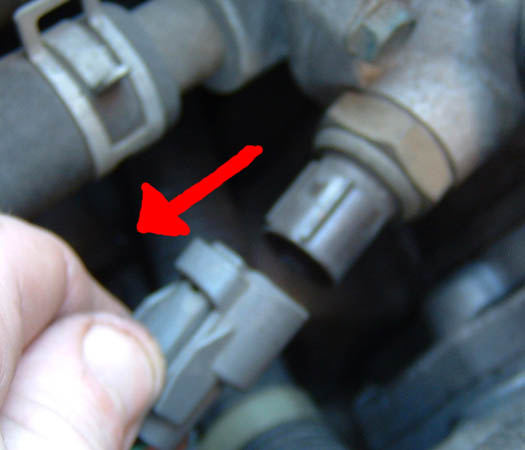

#11 Post by 1234dist » Mon Jul 11, 2016 6:30 pm
haven't got a pic of the d16 version but here's the location of the k-series one

Got ya
I think I know where it will be on my honda engine
