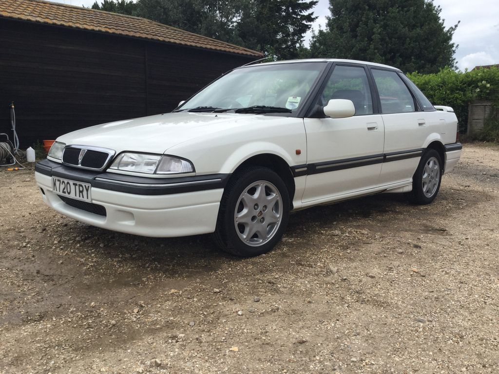

#38 Post by Lukeyboy46 » Sun Jun 04, 2017 3:32 pm
Just in case anyone is interested, cars going well, gave it a clean today, it's a nightmare keeping white cars clean...

Well she's finished, I purchased the engine, gearbox, ecu and loom from a 1993 220 GTI on 80k miles that had been broken on ebay. It was almost a drop in conversion.
The original gearbox actually let go in the end, so I figured by the time id paid for a recon and all the other bits I needed to do to the engine to stop it being incontinent, it would have cost the same as this second hand conversion unit.
I've managed to convert the car fully to a turbo (looking fairly original if I do say so) for under £800, which I didn't think is too bad.
It's totally transformed the car, its showed me just how knackered the other gearbox was with how smooth this drives.
I'm not out there for huge power gains and modifications or to ruin cars, I just wanted to make the car feel right and look stock. It flew through an MOT yesterday and had its maiden voyage last night which bought the biggest smile to my face.
I know the turbo conversion has been done to death, but hopefuly you will all appreciate this car for what it is. A 420 GSI Sport Turbo.
