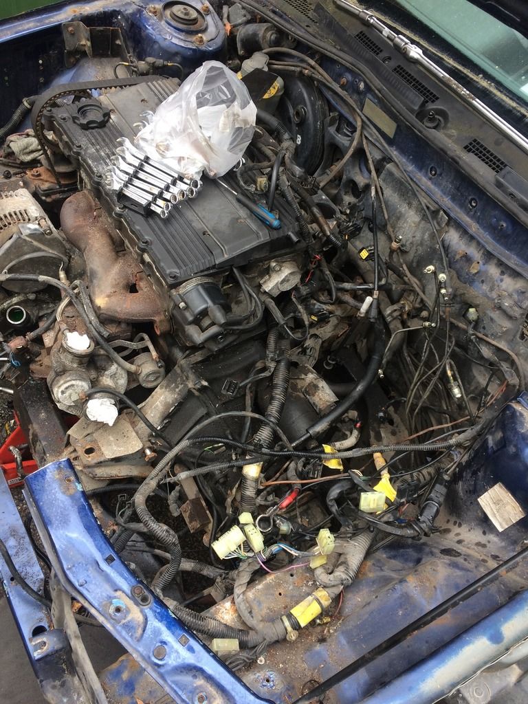

#18 Post by Johnny 216GSi » Mon Apr 17, 2017 5:57 pm

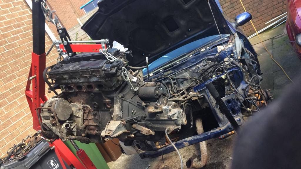

Unravelling the mysteries of the universe would be easier than this transplant, looking at the last picture.
Posts: 5308
Re: K785OAT - Project Black Panther
#19 Post by 1234dist » Mon Apr 17, 2017 6:17 pm
the last pic, basically ready to pull. Just need to disassemble both front suspensions now to get the drive shafts out and tatdahhh.
One engine.

Well, every now and again you get a win.

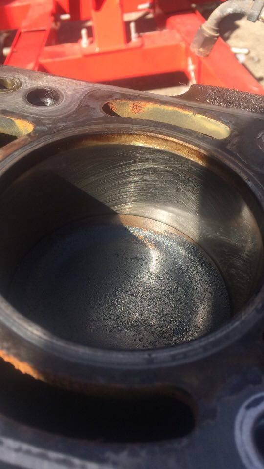

Engine was pulled from the donor car today and as with all my builds whether they require it or not the head gets rebuilt.
So we pulled the head off the donor car engine and was happily surprised to see fresh honing marks :D :clapping
So dug a little deeper with the sump off and can confirm i have a freshly rebuilt engine already :thumbup
Oil leak around the sump was due to the usual over tightening of the bolts which pinch the gasket.

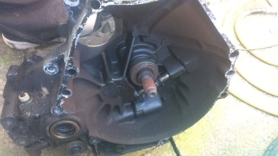

I even have a refurbed gearbox and, if i chose to use it (i probably won't) a relatively new clutch.
:useless
That must be close to £300+ and a days labour saved right there.

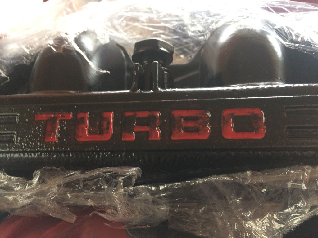

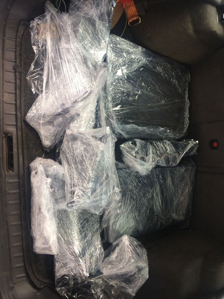

Powder coater has been very busy.
This is batch 1 of 3 :clapping
Posts: 1955
#28 Post by Johnny 216GSi » Wed Apr 26, 2017 3:25 pm
1234dist wrote:Powder coater has been very busy.
Can't recognise anything in the cling film. Obviously much more to a 220 than a 216 - can't think there's much beyond sub-frames and lower arms I need to plan for...

Upper inlet manifold (see below)

First layer of enamel paint.

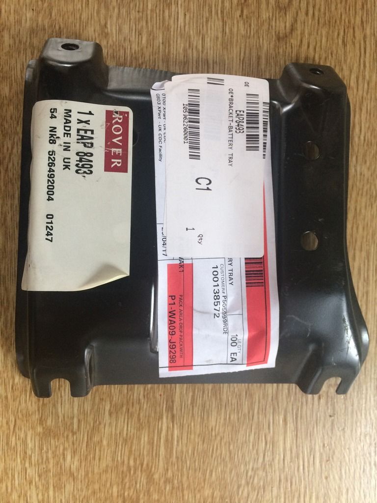

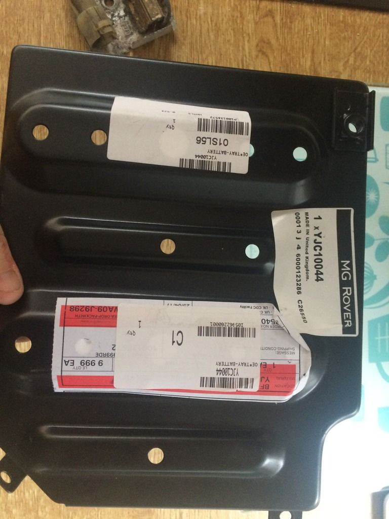

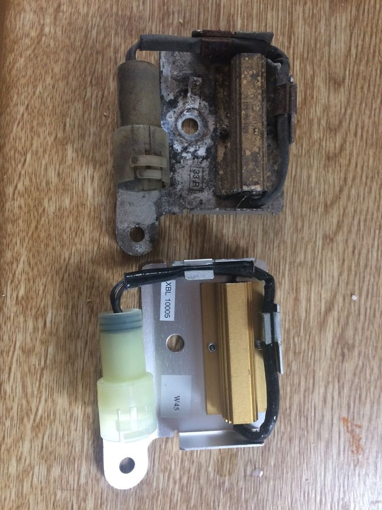

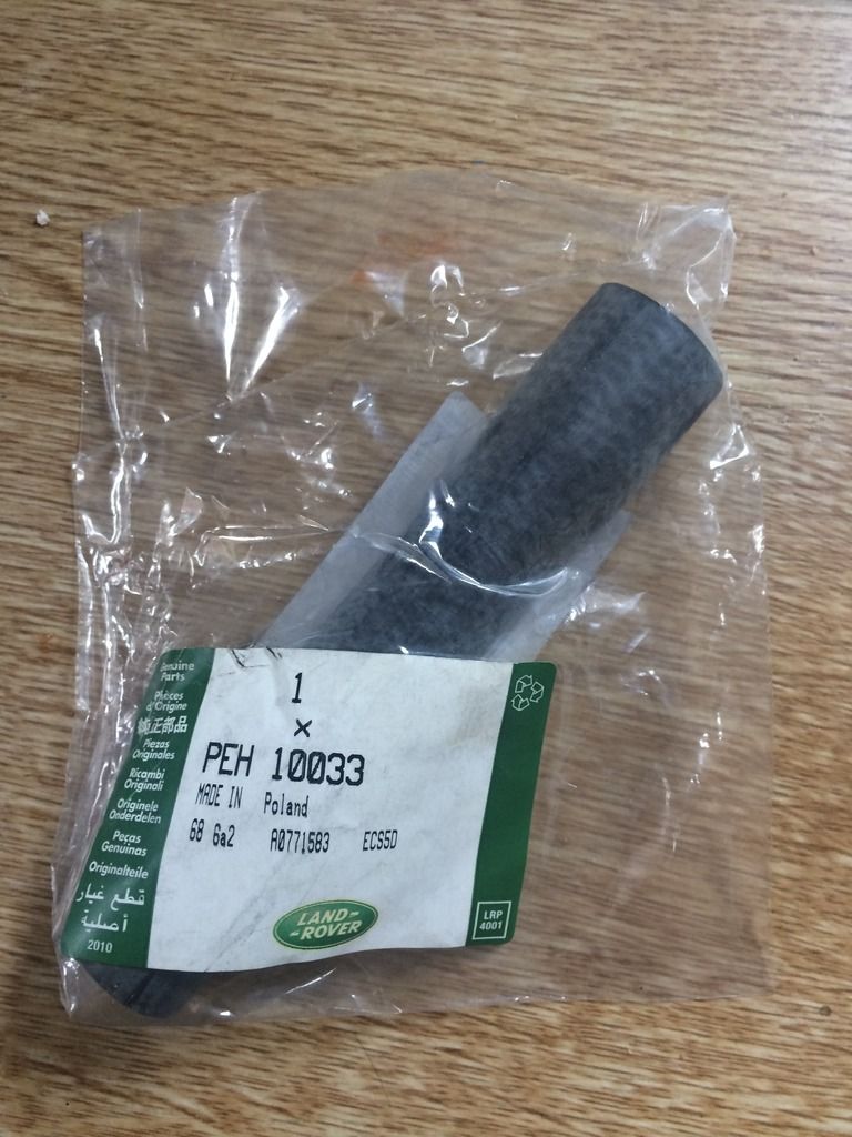

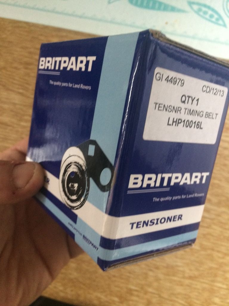

Posties been and brought me more shiny
Water pump to lower coolant pipe, Genuine :clapping
Replacement dim dip relay as i didn't trust the old one.
Another original coolant pipe
New tensioner as the old one looks rusty
Brand new genuine battery tray
And the bracket to hold it.
testing the boundaries of the New old stock out there this week.
:clapping
