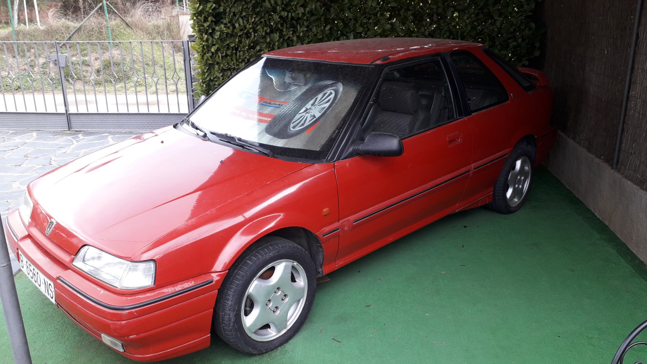

Just thought i would introduce myself, i recently acquired a 3 door 1992 220 gti 16v Cat with the M series engine, found the car in an open yard, it hadnt moved in 6 years, the sun has destroyed the red paint but but the rest of the car is intact with no rust at all anywhere, the beauty of no salt on the Spanish roads!
Needs full respray and a couple of front seats which i have already sourced and have changed all service parts on engine, it start and revs freely but its 140 horses have escaped somewhere as it feels more like a 1 litre metro rather than the GTI it is.

Spanish 3dr 220 gti 16v cat in red sees the light
