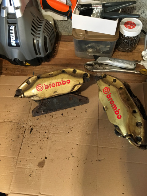

Some more back ground on those front brakes would be interesting? I'm always aware that the standard brakes are a liability especially on the Mway.
Re: Vinny's Rover 220 GSi Turbo Diary of sorts 2010 - Today
So the brakesMr Teddy Bear wrote: ↑Mon Jun 03, 2019 12:24 pm Nice thread, keep the pictures and commentary going Vinny!![]()
They are a 326mm mk1 RS Focus front disc redrilled to 4x100 and they have a mm taken from the centre bore to match the rovers.
The calipers are a brembo 4 pot from the 3.0V6 406 coupe
Plus a steel adapter plate and 4 bolts some washers and small spacers
It’s a great kit that was once a group buy on Rovertech, minus the calipers
I do have a spare set of the steel adapters if anyone thinks they could get them copied, maybe a group buy on here of 5 or 10 sets if anyone else wants this conversion.
You can get discs redrilled for around £125 which includes purchase via mtec
The calipers are pot luck £50 to £150
Rebuild kit price is £60 easy job

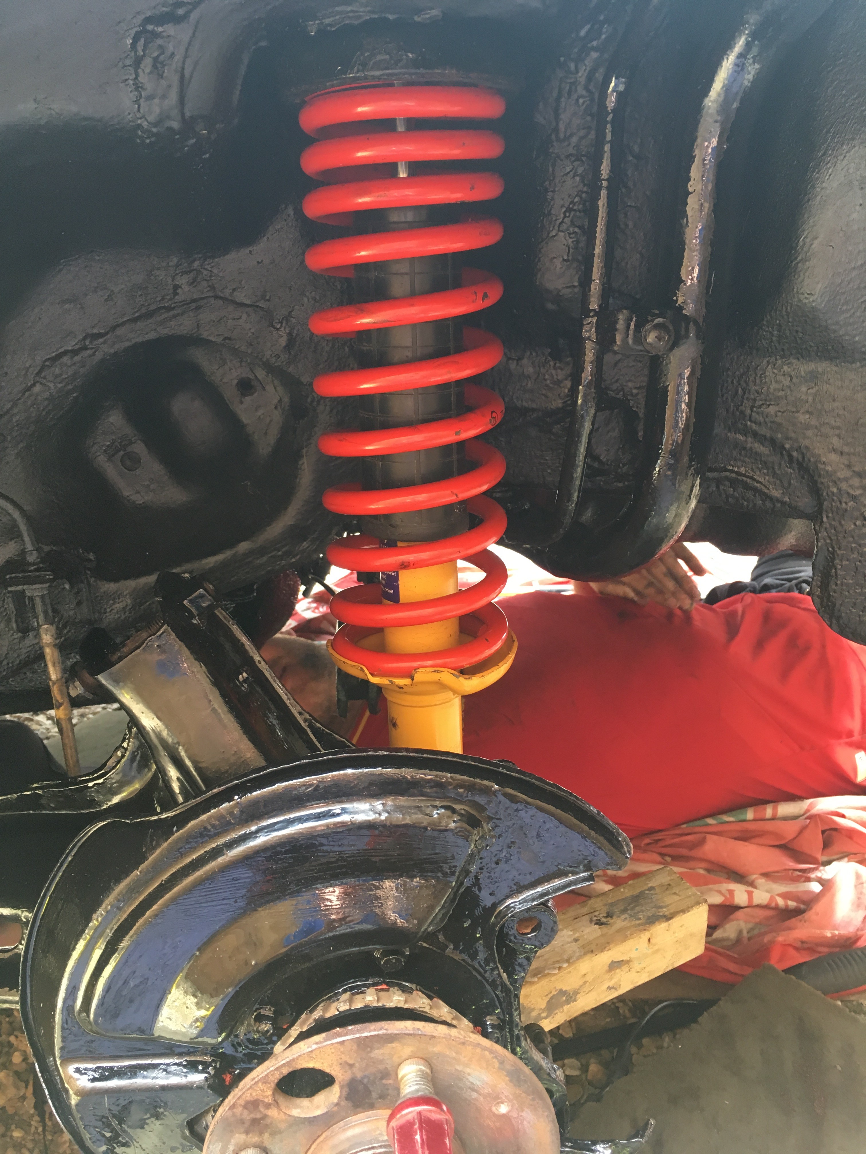

Rear during rebuild - Nov 2018 - Spring was rotated after this, may swap springs mind as unsure on quality

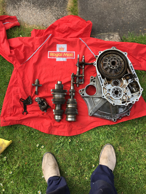

Gearbox - Summer 2018

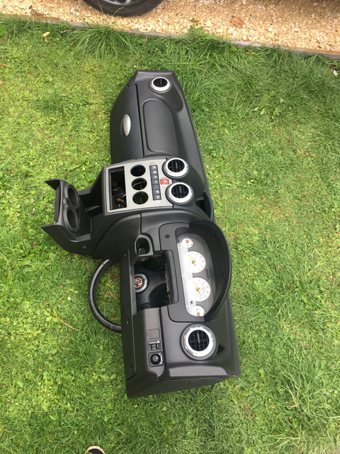

Got this mk2 zr dash knocking about, may look at installing it after the summer with the mk2 switches

Mk2 Dash will freshen it up a bit bud.
