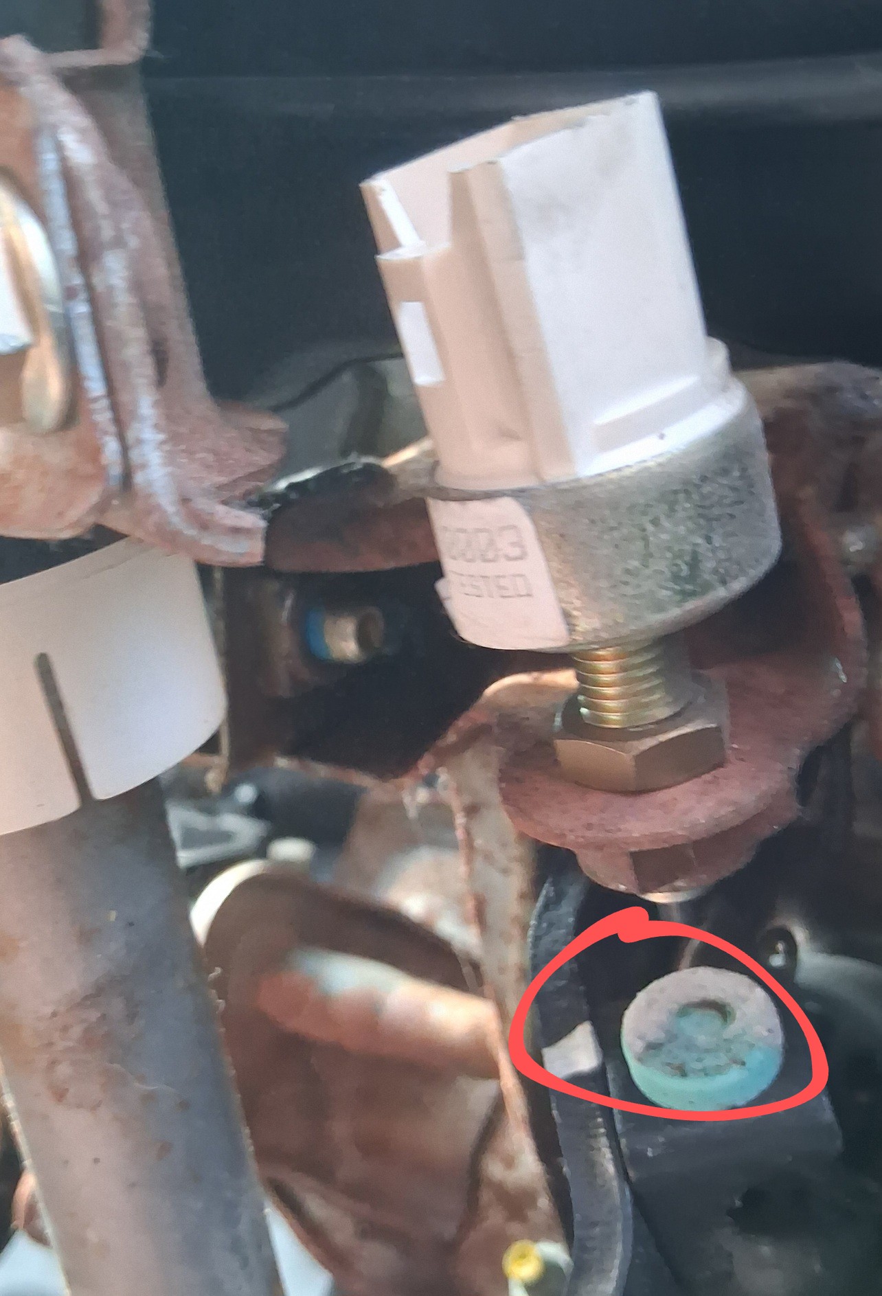

Thanks, I can see the piece I'm missing in your photo, I've circled it in red

Re: Brake lights stay on
Thanks - that isn't the part I need though, it's the piece that goes between the pedal and the brake light switch that is missing
Hi, thanks for the offer! I'm not able to go this year unfortunately though
I was doing my pre-MOT checks this morning and discovered that the brake lights are always on regardless of the pedal position(!). Investigating the switch that is pushed by the pedal, there is clearly a missing piece - the pedal has a bracket with a small hole that is evidently meant to contain a p...
