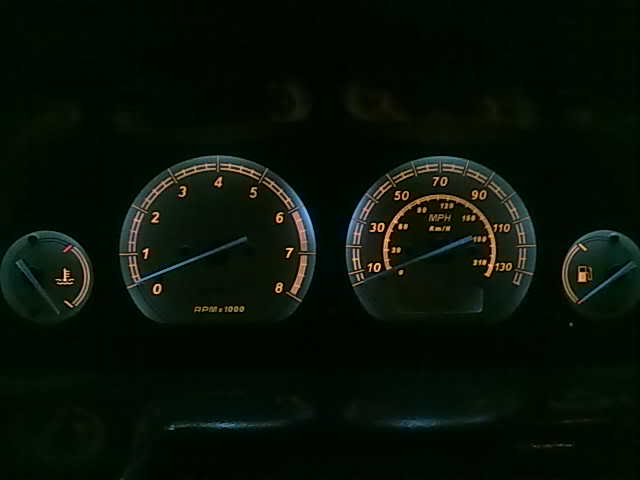

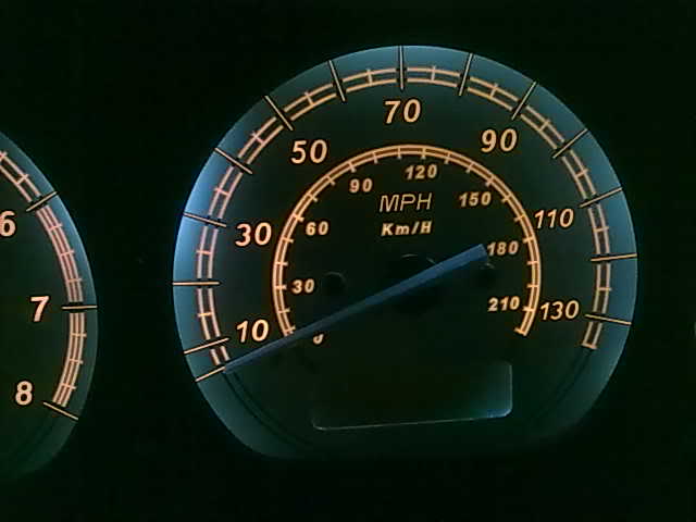

I also found the pics of my ROVER 25 dials with cool white LEDs behind them. They still lit up OEM orange but with a nice modern glow.
