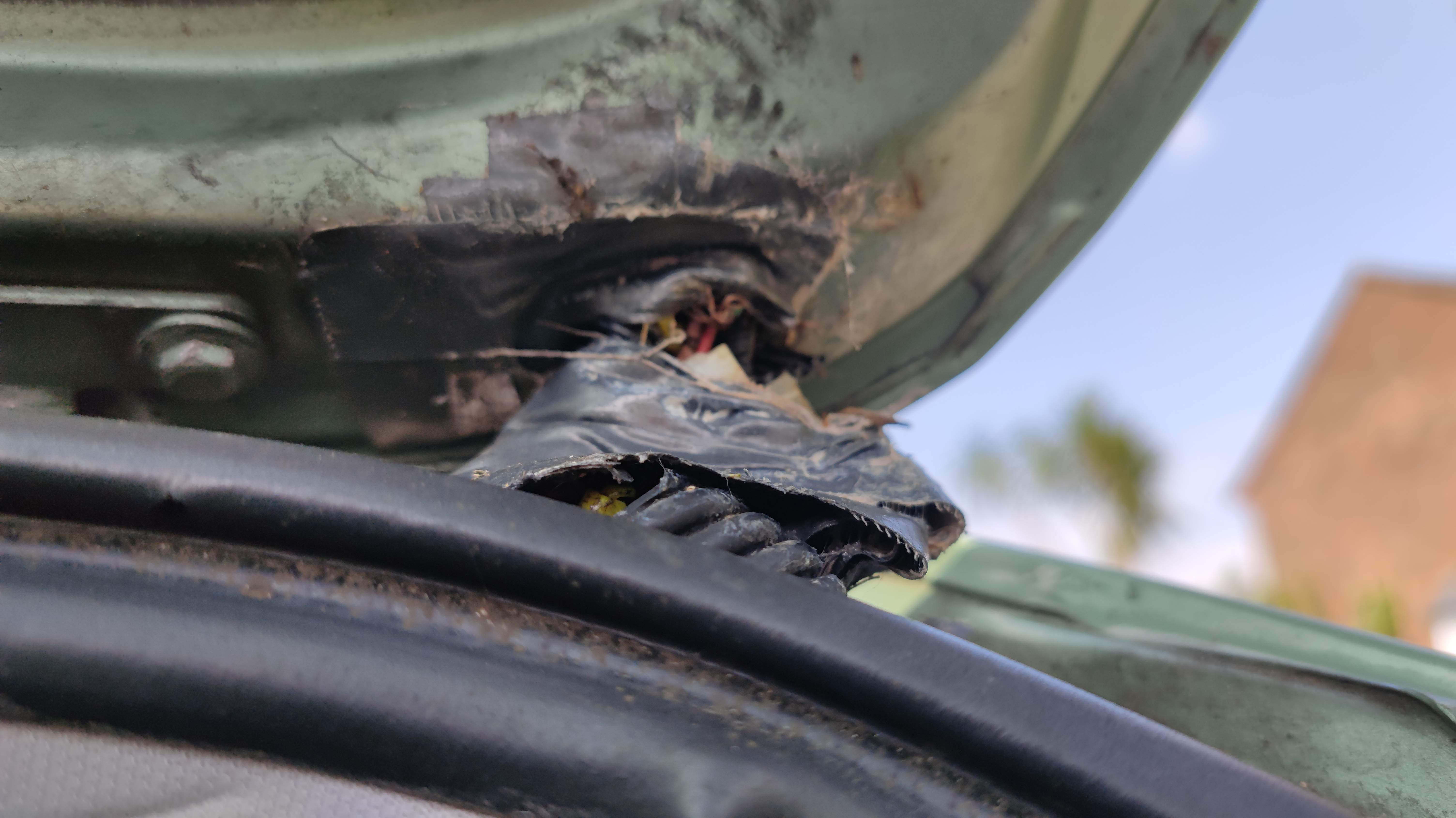

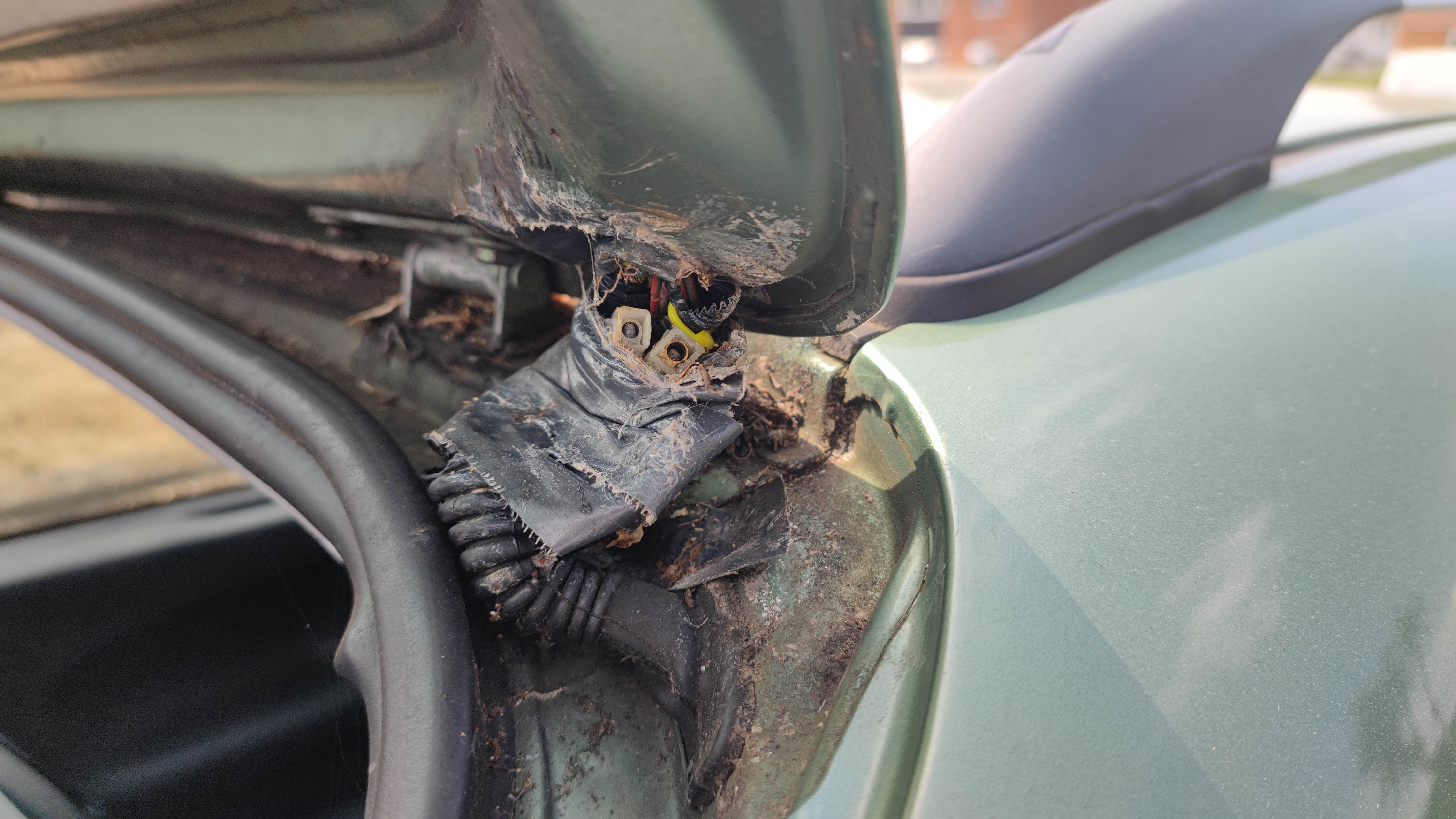

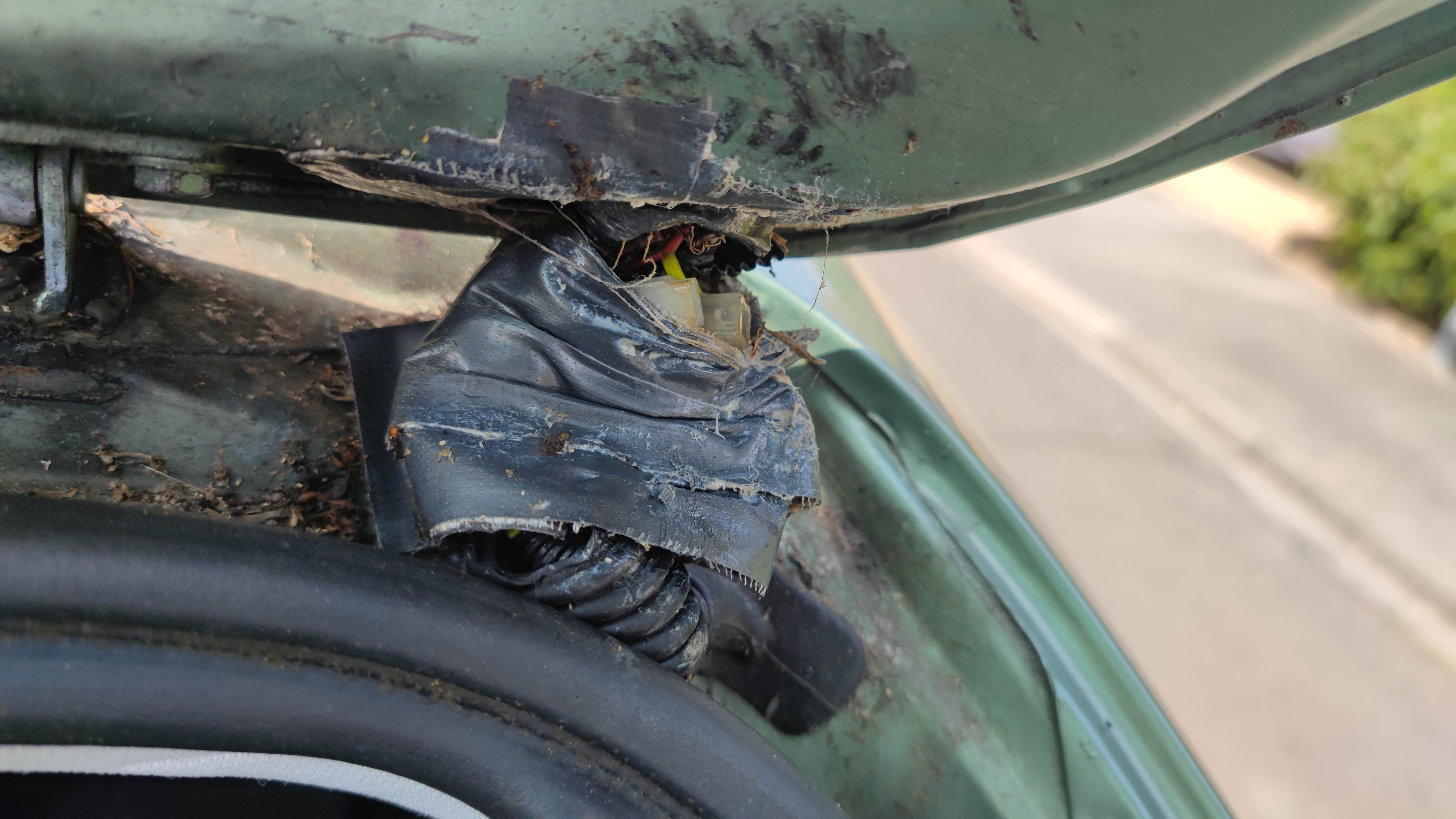

Thanks for the reply. The drive to Portsmouth went well, the drive back bought the engine management light on, however it was fine, it got me home and didn't go into limp mode or anything. I borrowed an ODB scanner and it came up with P0420 Catalyst system efficiency below threshold. I've cleared the code and it hasn't come back yet so hopefully that was just some carbon getting cleared out, apparently it hasn't been on a motorway for about 15 years. I'll attach a couple of pictures of the tailgate loom, someone has already been in there with chocolate blocks, I'll have a go at replacing the sections of wires with some of that really flexible silicone covered stuff. Thanks for the info about the fob, I'll get onto him. I am hoping to get to Milton Keynes for the rally in September so hopefully see you there.

That wiring harness looks a mess! Hopefully cutting out the prior repairs and extending the harness with some new wiring & proper soldered repairs will do the job.

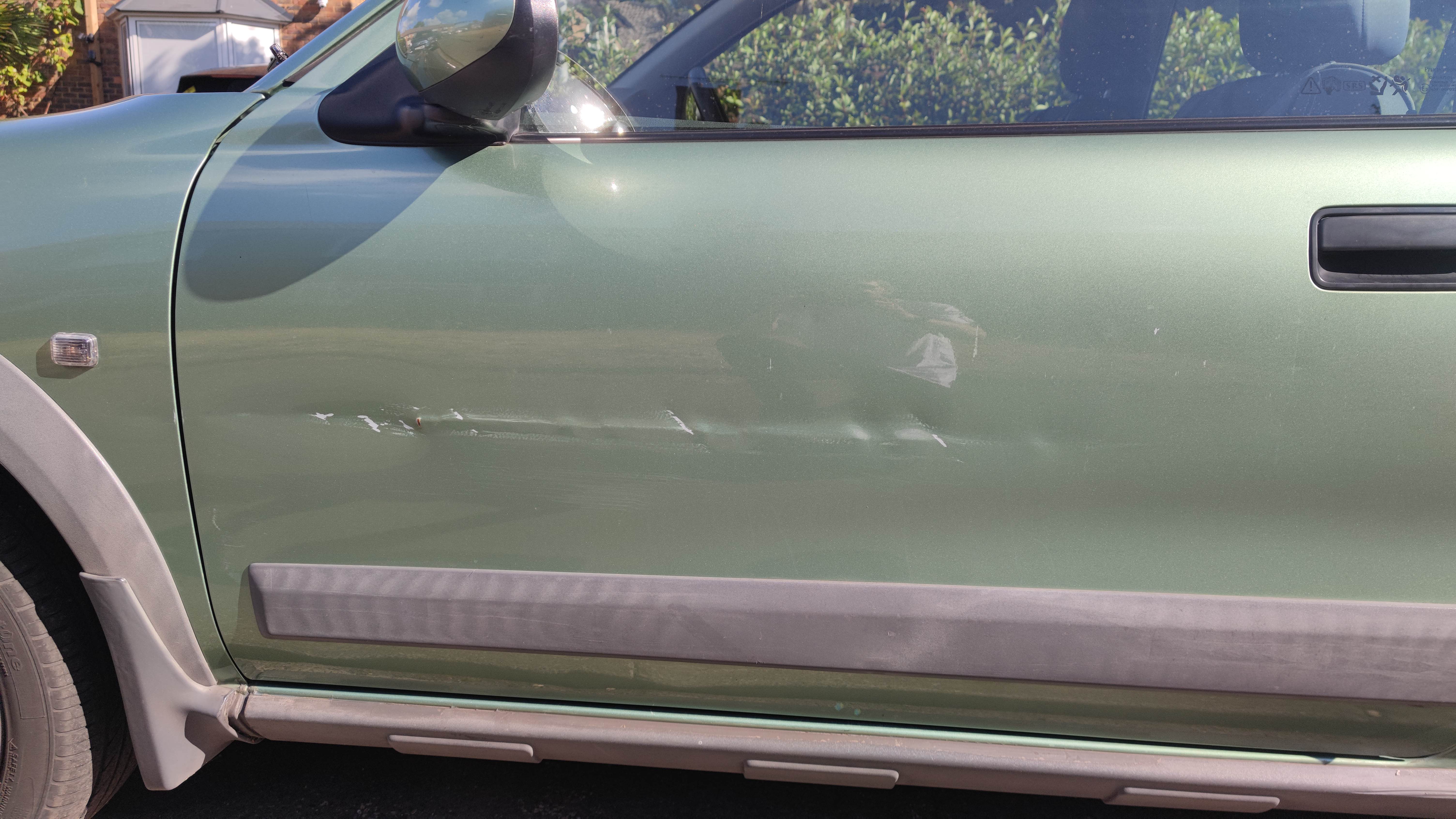

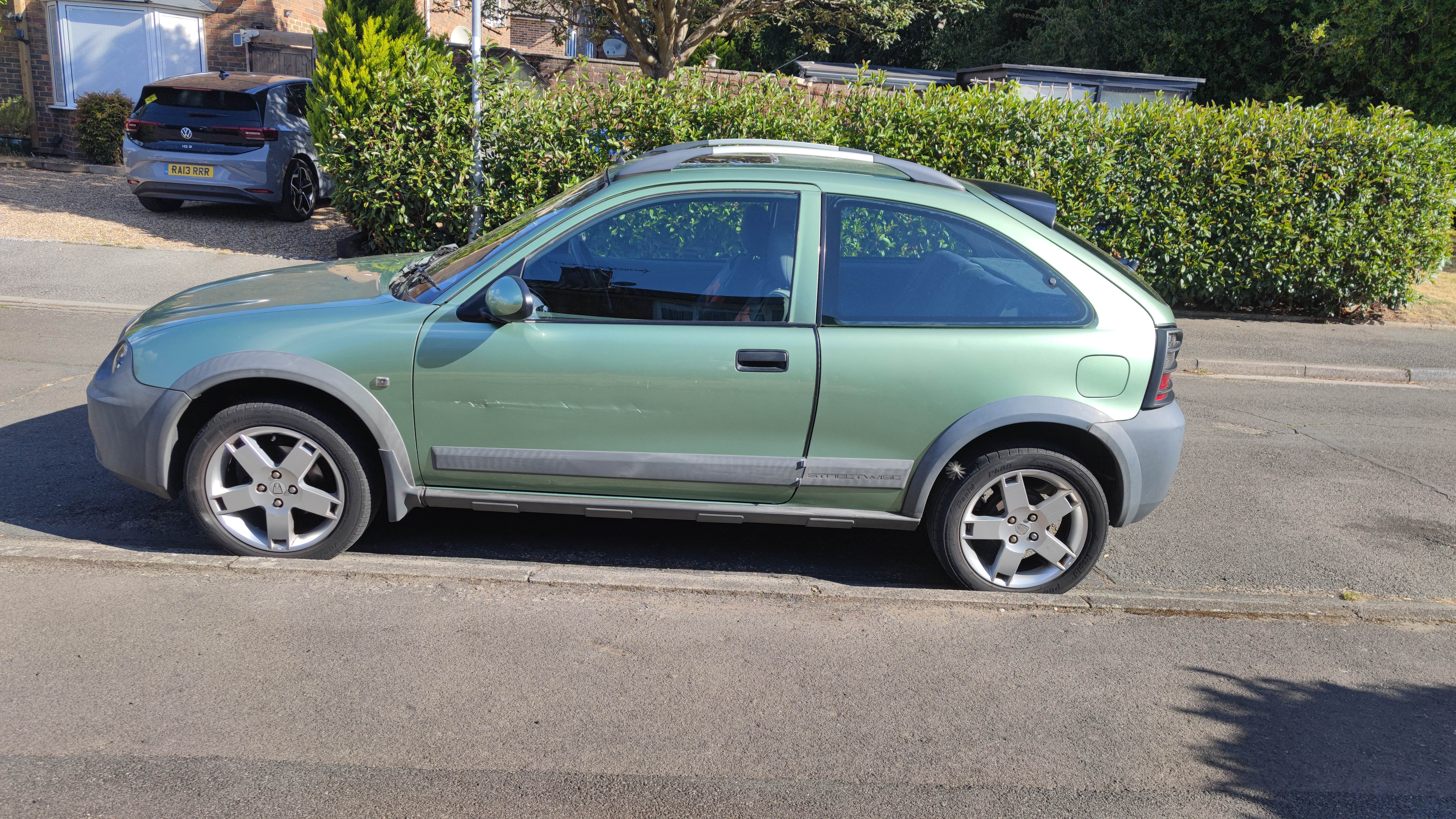

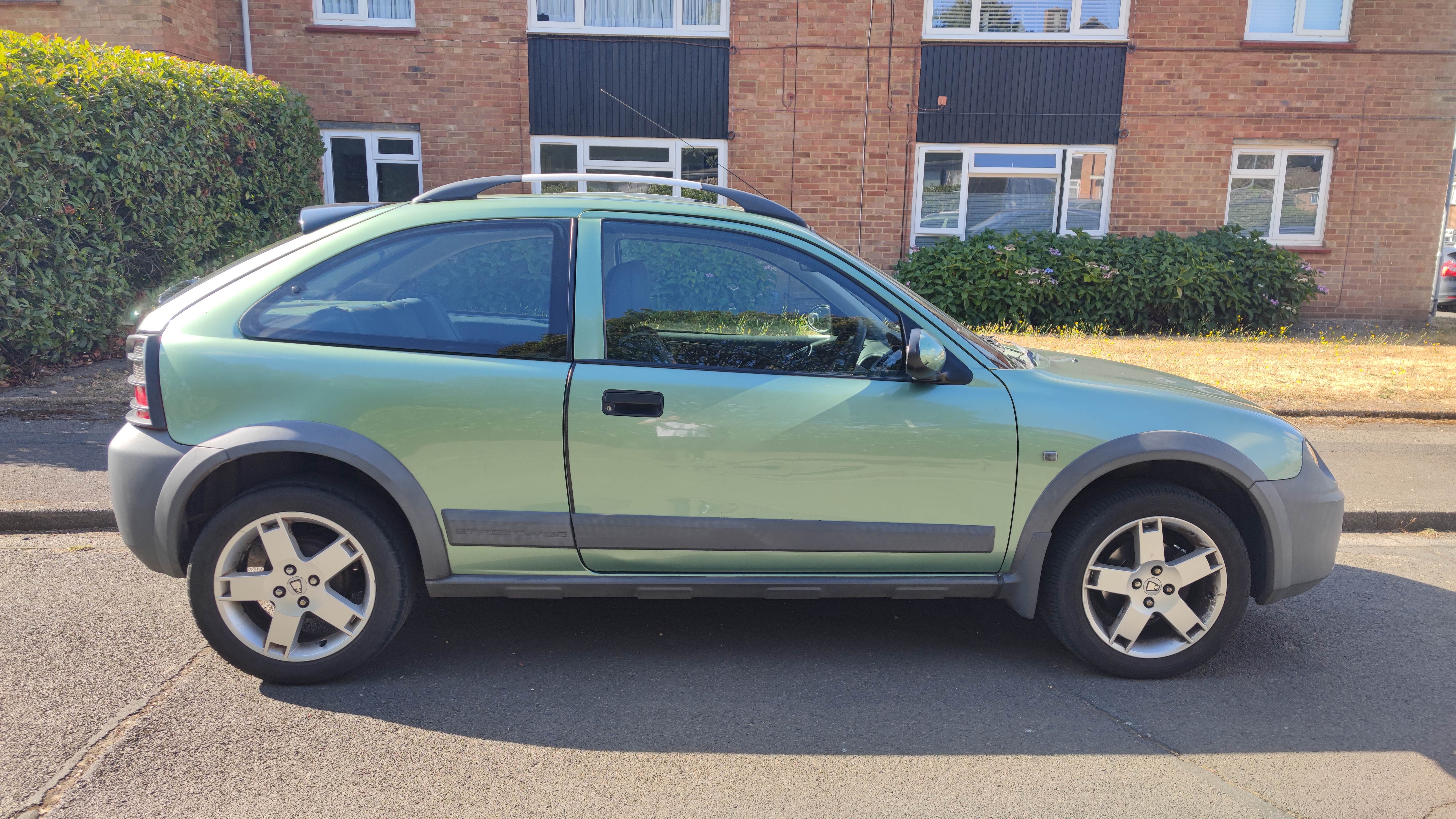

That looks cool, dare I say it but the scrape actually adds to the Streetwise charm!
