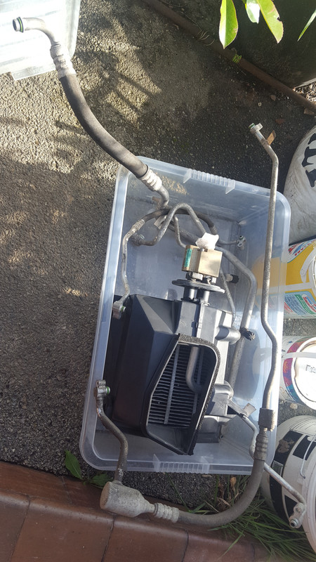

Re: R8 A/C
The engine back is almost identical to a ROVER 25 (MG ZR), find a scrapper or raid a scrappy.
I stripped out the system from a ROVER 25 for my Cabby, I cross-referenced all the pipes and parts from RIMMER Bros,
90% is the same, I am running a K-Series though, Honda or Diesel is a different matter.
- Forum User
- Posts: 1760
- Joined: Wed Feb 17, 2016 1:17 pm
- Location: UK
Re: R8 A/C
Fit new O-Rings too!!
