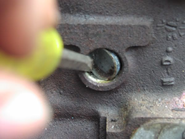

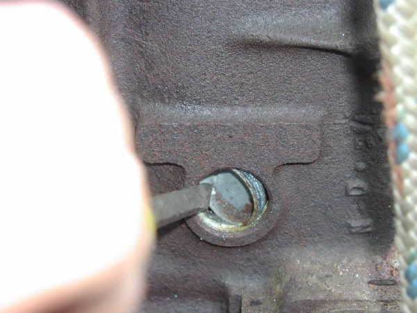

2. Place blunt screwdriver or chisel into the side of the plug ..and begin to tap with hammer.
The idea is to twist it in its hole like a butterfly valve.

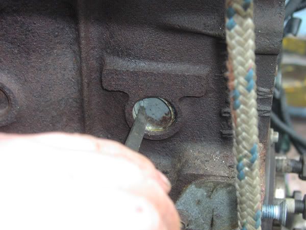

3.continue to tap more.

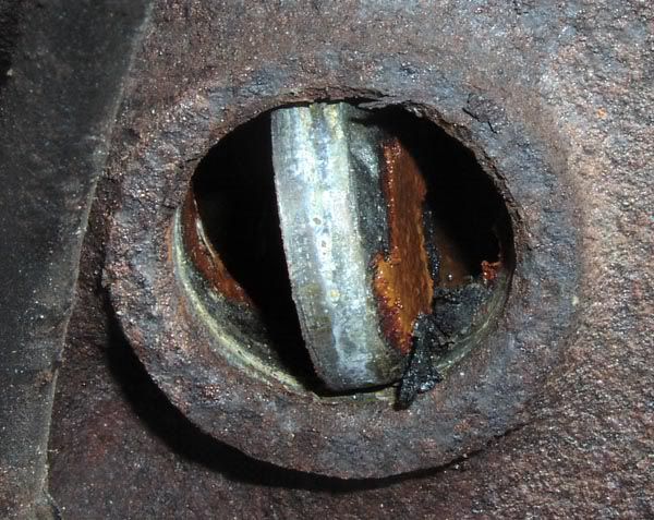

4.
5.

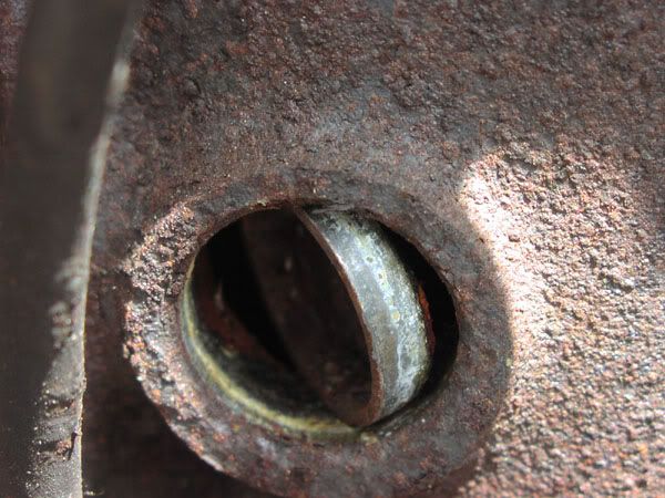

6. At this position...it can be just flicked out.
7.out
