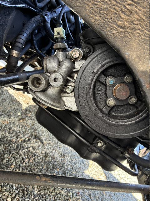

I was having some serious oil leaks which I’d been putting off addressing but the time finally came. The car was dripping on the driveway - it transpired the front of the sump had rusted through.
Furthermore the head gasket was leaking oil. I’d fixed the cam cover gasket leak but I knew a new head gasket was inevitable.
Pressing my e36 cabrio into use for the summer I’ve replaced the sump:

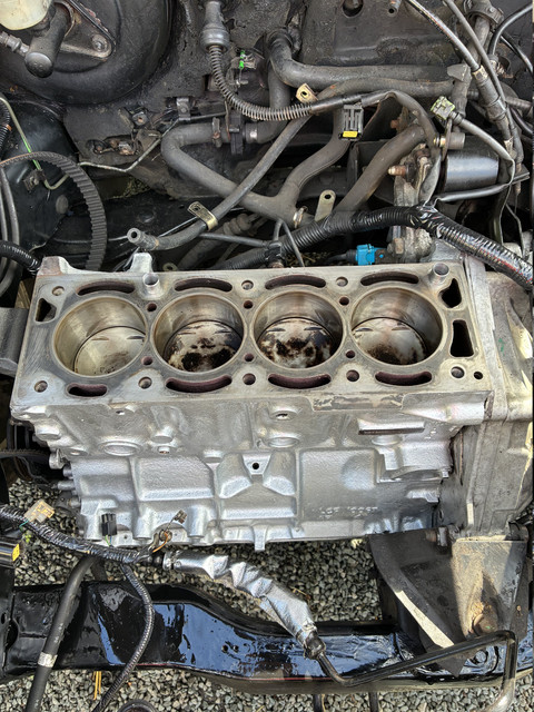

Cleaned up the top of the bores - 105,000 and if you run a finger up to the top of the bores there is zero wear! They were carbon deposited up, so I cleaned that up gently and painted the block. The block was perfectly flat on top so required nothing but a clean.

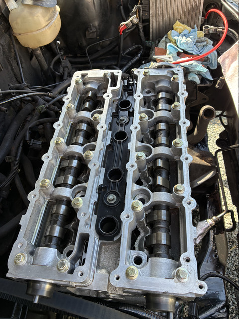

Lockside Engineering in Castleford fitted new cam seals, lightly skimmed the head, fitted 2 new valves, re-rounded 14 others, and drilled out snapped bolts in the water pump mount (£444 - not bad value). I refitted with a gasket from DMGRS which is meant to resist leaking oil.
I found the power steering pump was broken with snapped off metal tooth so replaced this and the water pump and fitted new belts and tensioner.
